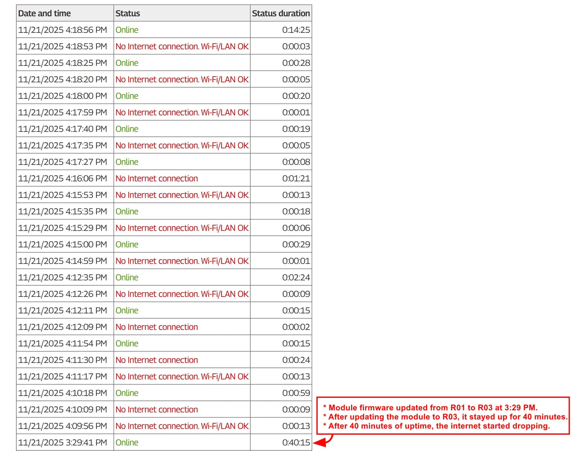

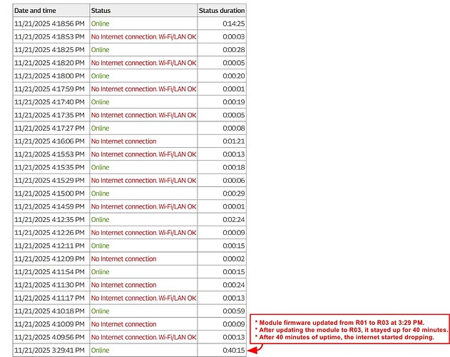

I just again tested R03 Firmware (RM520NGLAAR03A04M4G_A0.301.A0.301).
But, i got unstable internet. No problem if usea any R01 firmware.
same problem with All R03 branch firmwares.
  • Module firmware updated from R01 to R03 at 3:29 PM.
  • After updating the module to R03, it stayed up for 40 minutes.
  • After 40 minutes of uptime, the internet started dropping. and Also internet speed fluctuate, some time very very slow internet speed and high ping time. hanging internet…

i am 100% sure it is R03 firmware issue. if i use any R01 branch firmware then no issue never single disconnect, never speed down always work fine.. And i already using R01 firmware continue 24x7 since 6 month never ever issue.
But, when i use any R03 firmware then start problem unstable internet, slow speed, high ping, internet hanging issue..
i use 5G SA.
Other user also face same problem with R03 firmware and no issue if they start use R01.. Already discuss on this forum.
:backhand_index_pointing_right: Read forum post.. 3 users already having same problem.
I hope this is enough to you and quectel for accept this R03 firmware issue..
