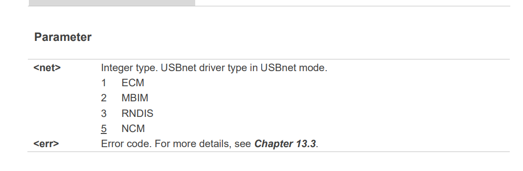

Please check data call mode via AT+QCFG=“usbnet”.
The default configuration is NCM.
it’s in NCM indeed, but I can’t change it to MBIM

What do you mean of can’t change it to MBIM?
Do you try to configure via AT+QCFG=“usbnet”,2 ? And install corresponding driver.
