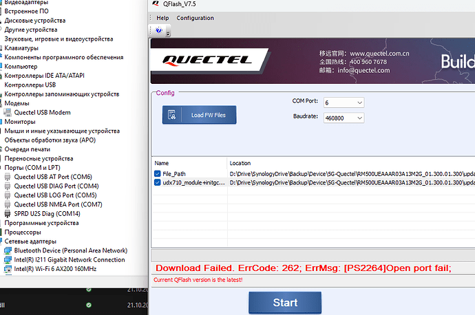

Please help, I have installed the latest drivers, but I get the error
Download Failed. ErrCode: 262; ErrMsg: [PS2264]Open port fail;
