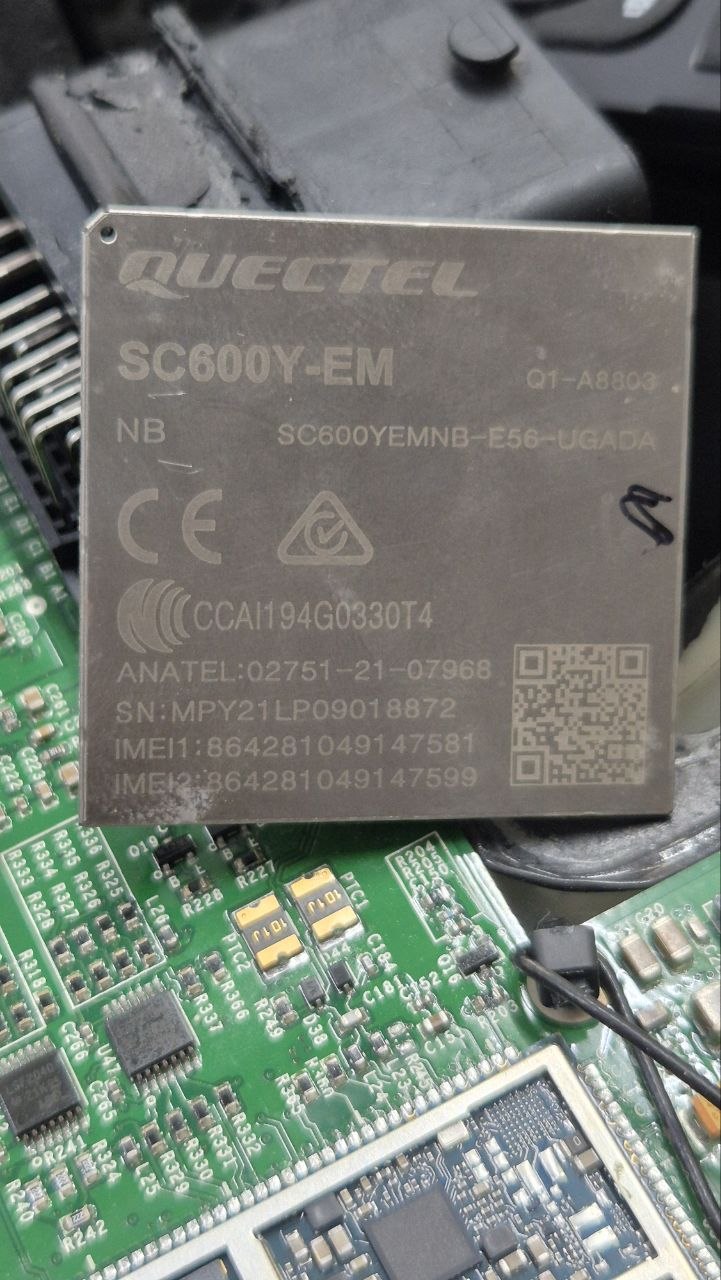

Hello, I am writing this post because I am already desperate, I cannot find any of the complete firmware for the SC600Y chip in my car screen. I think that when trying to flash a different splash.img it stayed in bootloop and has not booted again, the Android 9 part. I left the log read by TTL with UART. I hope someone can help me and share if possible the complete android 9 or 10 firmware for this chip. I look forward to it, thank you all in advance.

LOG UART HEADUNIT AUDI SCREEN 8.8"
motherboard
Dear, JavierPB:
Can you help provide the full OC of the module?
You can find it on the shielding cover.
Hi friend, this? I don’t know exactly what OC is

Ok, I have tried the firmware that you sent me, although only the boot.img, splash.img and some other things but it doesn’t exist. How can I know from the backup I made via EDL, which image has the problem and blocks the device from booting the Android part?
I am attaching the zip with parts B, which is the slot used by the device. Logically I have verified that both parts A/B are identical.
In the uart ttl log, you can’t see what is happening, does anyone understand?
Can anyone help me or enlighten me on how I can proceed? Thanks in advance

No, I am not developing my device, I am trying to repair corrupt software after a failed update. I “think” the image, “splash.img” or configuration file “factoryconfig.xml” was corrupted, and has locked the screen. And by not having a complete backup from before the update, I don’t know where the problem comes from or which partition is corrupt or with only zeros. Can you help me?
