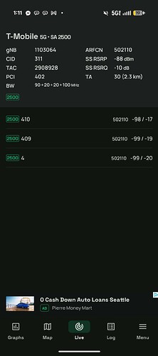

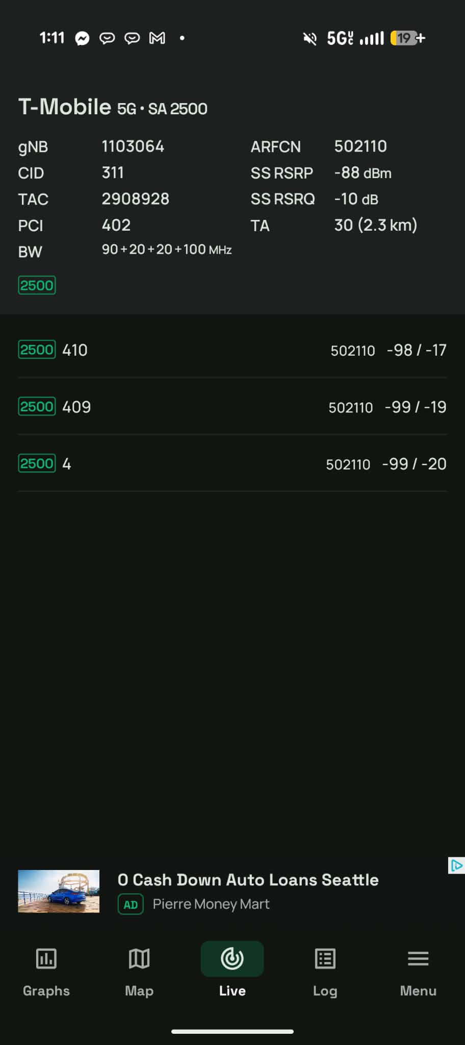

Experiment 2, same-site cross-check with a Pixel 10: At the same location on the same cell (PCI 402), a Pixel 10 under load showed 4CC at 100+20+20+90 MHz (from an NSG log, excerpt attached), and later NetMonster showed it camped on 502110 (90 MHz) with aggregated BW 90+20+20+100 MHz (screenshot attached). So the network here does hand out n41+n41, the modem just never gets it.

  • NetMonster screenshot (Pixel 10, camped on n41 502110 at 90 MHz, aggregated BW 90+20+20+100 MHz)
