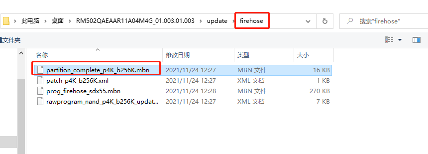

I have a question on the flashing: What file do i choose to flash? In QFlash I click on load files, point to the fw file but which file do I load for QFlash o be able to find the update?
Thank you
Do not look at the modem and fw version, we are only interested in the specified folder and file.
Yes, that works perfectly. For loading the files, I now get a fail on the upgrade as a timeout on com6 which is the port of the modem. It first goes thru a cycle.
