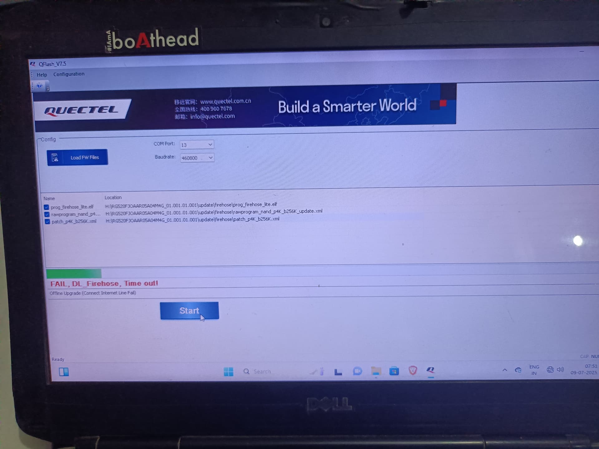

I have rg520f module which have firmware rg520fjoaar05a04m4g and I am trying to upgrade it with firmware RG520FJOAAR05A04M4G_01.001.01.001.zip which is. Provided by quectel support for this module . I am using qflash_v7.5 . I entered EDL mode and try to flash this firmware usb is shown in device manager and also passed by qflash but after starting it show fail dl_firehorse , timeout . Please help regarding this issue

I tried but it fails always i locked my bootloader with a cutom signed fw . So now mynew fw with same specs but not signed by that sign is not flashing

Yes secure boot is enabled . Due to secure boot firehose is not working and also sahara mode fails .
Dear @ankit1
If enable secure boot, please contact with your supplier to get the firmware.
My supplier is not providing firmware . Does any way to flash custom quectel firmware of this model by erasing whole data of module
Dear @ankit1
Sorry, we don’t have this.
