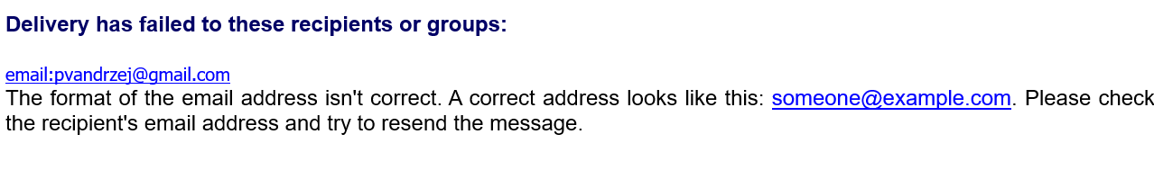

By the way, The email( email:pvandrzej@gmail.com) you provided appears to be invalid.
Therefore, I have sent the firmware to the email address listed under your forum user profile.

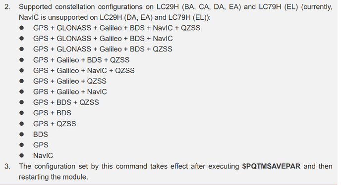

I have an LC29H EA module, but it has stopped tracking anything other than GPS satellites. Although I have issued commands such as PQTMCFGCNST to enable the use of all satellites, the situation remains unchanged.
Could you please provide the latest firmware with improvements?
The current version is:
$PQTMVERNO,LC29HEANR11A03S_RSA,2023/10/31,16:52:14*2B
raspico@outlook.jp
Hi @raspico, pelase check your email, I have sent you latest firmware LC29HEANR11A04S_RSA with related upgrade guide.
To change the constellation configuration, after sending PQTMCFGCNST, you will need to send $PQTMSAVEPAR*5A and then restart the module.
