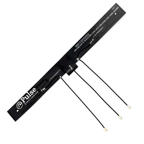

We are using this antenna if there is any recomennded antenna please suggest
Hi,
1.According to the signal quality of the module network you sent above, I think the reason for the antenna may be small.
2.Can you successfully ping IP directly.

  3. Can you suggest better antenna for the EG25. The antenna we are using https://sixfab.com/product/lte-main-diversity-gnss-triple-port-u-fl-antenna-100mm/
If it is antenna problem please suggest a better antenna for EG25 for lte.
Hi,
1.The antenna parameter requirements of our module generally meet the antenna parameter requirements in the hardware manual of the corresponding module.
2.If you need my recommendation, you can choose one from the list of antenna products in our official Quectel flagship store, such as the one in the picture below
(https://yiyuanznsb.tmall.com/)
This is our domestic website, and I am not sure whether you can log in and purchase successfully. If not, please refer to the antenna parameters in the hardware design manual of EG25 to purchase from your existing purchase channel.
Thanks.
