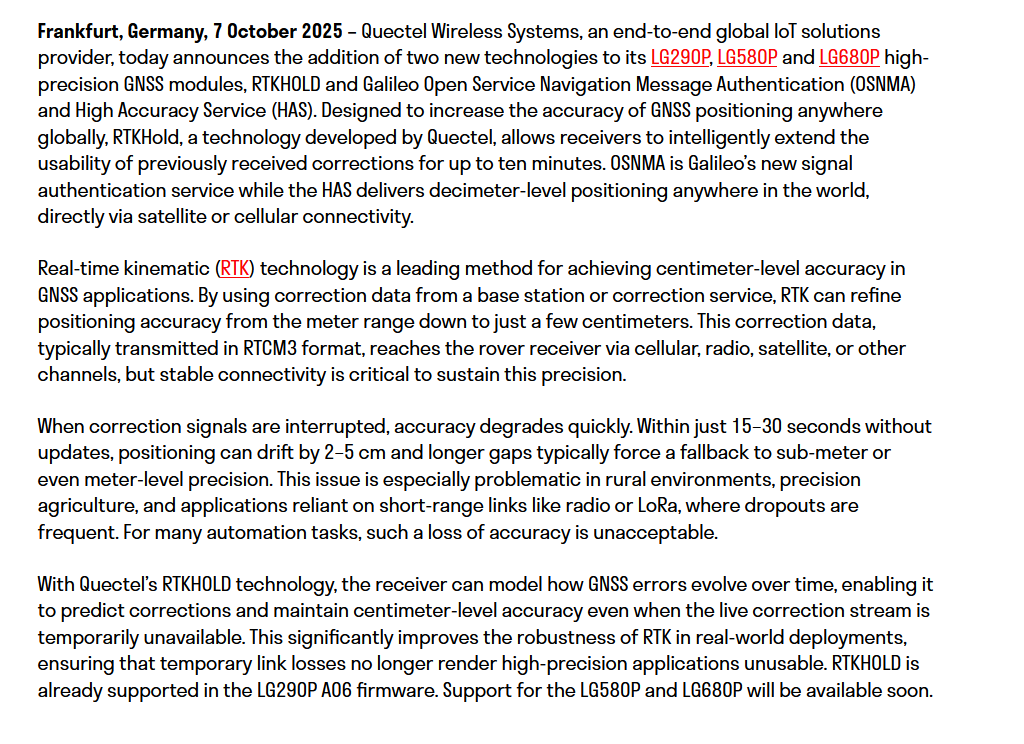

Good morning.
Sparkfun already has a beta or test version 06 for the LG290p, and Quectel reported at the conference in Germany that version 06 was compatible with Galileo HAS.
I want this final version 06 to test Galileo HAS.
You can see Quectel’s information on version 06 and the LG290p and others at the following link.
