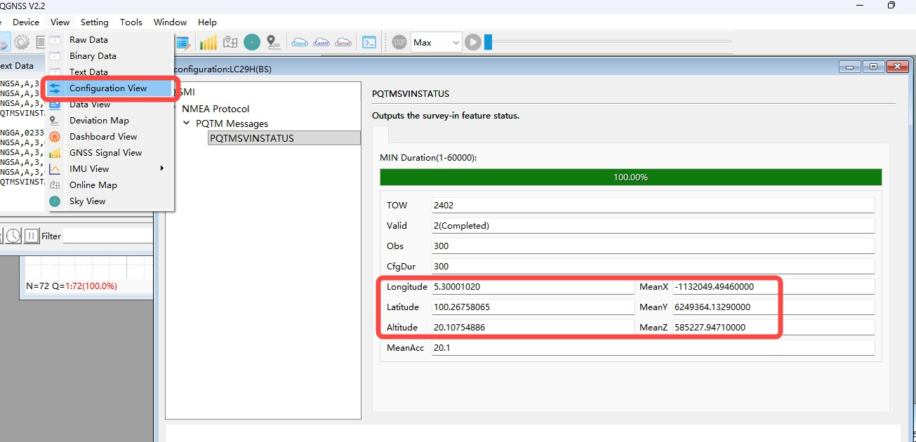

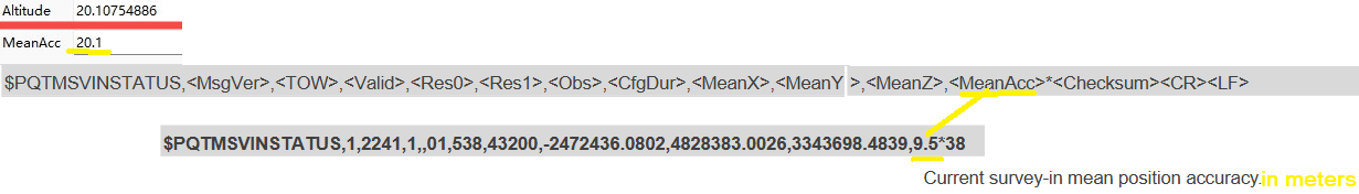

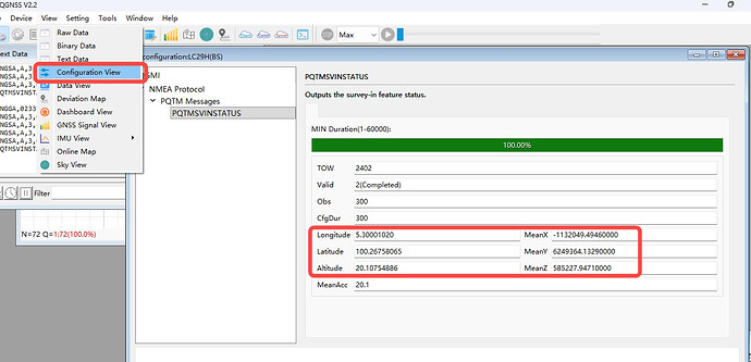

Something I’m noticing is that the survey in status doesn’t really seem to make a whole lot of sense. What’s the expected behavior? If I start a survey with the command used above at #11, and monitor the SVINSTATUS messages, it seems as though the number of observations used holds (in this case, at 22) and CfgDur is set to 0. The valid flag is 2, which I interpret as “the self survey has completed and a valid fix has been found”. This doesn’t make sense to me, because the minimum number of positioning times I set was 3600. If I query CFGSVIN, I still see that it is set to 3600.
$PQTMCFGSVIN,R*26
$PQTMCFGSVIN,OK,1,3600,1.2,0.0000,0.0000,0.0000*77
$PQTMSVINSTATUS,1,235388000,2,,22,1,0,163####,-422####,446####,1.6666*3C
Is this expected behavior, am I doing something wrong, or a firmware bug?
