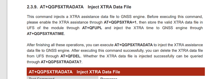

I’ve discharge it and upgrade the firmware succesfully into my module RM520N-GL module. This upgrade was done, in order to charge manually or donwnloading by the module itself the xtra2.bin or xtra3grc.bin files seeking to activate the AGPS. Despite to succesfully load the new firmware and load manually with at commands the xtra2.bin or xtra3grc.bin using “AT+QFUPL” and activating the AGPS with “AT+QGPSXTRA=1” and correct the system time using “AT+CCLK”, when executing “AT+QGPSXTRADATA?”, the module responds with:"+QGPSXTRADATA: 0,“1980/01/06,00:00:00”. Can you help telling me how properly charge this files to improve the GNSS fix time with the AGPS?

Before injecting XTRA data file, inject XTRA time first through this command. I have sent GNSS document to you via Message, please check.

Silvia,
Thank you so much, it worked.
