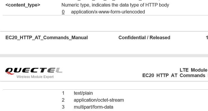

Hi All,
I am new to quectel and i bought quectel EC20 EVB.
In my application i am using HTTP and i need to send data in JSON format.
But i cannot find any way to set Content-Type as application/json.
If you know how to set application/json please guide me.
In document only four method is available to set content type.
If content-type = application/json is possible then please explain that steps.
Thanks,
Hardik
