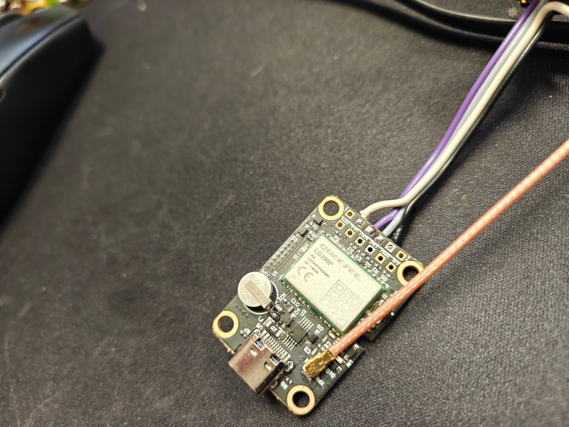

Hi,
I bought an LG290P module from Aliexpress that has some weird FW in it.
For starters, commands are not $PQTM**** but $OPTI**** and VERNO lists the following:
$OPTIVERNO,LG290_SDK.1.2.0_GNSS.1.1.6,2024/11/18,20:06:08*0F
Can I flash LG290P03AANR01A04S on it or will it brick the module? Is it even a genuine module?
Please can U post your (real) module photo?
U can also try if (the equivalent) of $PQTMUNIQID*16 works, but send the serial number only to support@quectel in private…

Sure, here’s a picture of the actual product.
Send the uniqid through email.
Ok, so the serial n. works?
Imho the chip seems legit…but ipx (antenna) connection is not good…

Most of the PQTM commands work by replacing $PQTM with $OPTI.
Module works, so I’m hesitant about updating the FW.

The antenna connection definetely adds to losses, can’t get a fix indoors where my phone gets almost immediate fix. But outdoors I was able to get good enough reception to get 20 mm RTK fix.

Hello,
I have exactly the same issue as extin. In my case I already tried to update the firmware with the QGNSS but it does not sync. I followed the guide, configuring the baudrate and reseting the module.
So it is likely that it is using other/older protocol or, I hope not, the module is a clone.
Also contacted support sharing the ID as bamarcant suggested but they only redirected me here.
