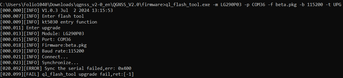

I used a separate serial port for sending the command. Tested the firmware update on UARTs 1 and 2. The QGNSS always reports the sync error after 20s of trying, Sync the serial failed,err: 0x400. I can see the tool sending the sync packets but the LG290P does not respond.
Bummer.
So it would seem that the update protocol might be different as well.
Seems that only option is that we get support from Quectel.

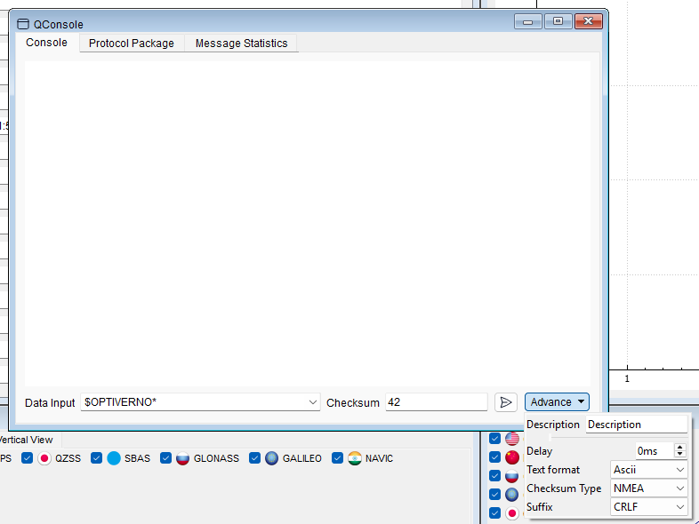

All PQTM command need to start $OPTI, eg. if the command is $PQTMUNIQID it has to be changed to $OPTIUNIQID.
And you need to turn on NMEA checksums:
In console right bottom there’s Advance->Checksum->NMEA.
Then the console will add correct checksum to the message. See attached picture. And you need to add asterisk, * to the end of command for the checksum to be calculated.

[2025-04-06 22:20:19.032 Uart Tx:0015 B] $OPTIVERNO*42
[2025-04-06 22:20:19.097 Uart Rx:0063 B] $OPTIVERNO,LG290_SDK.1.2.5a_GNSS.1.1.9,2024/12/20,18:24:13*6D
