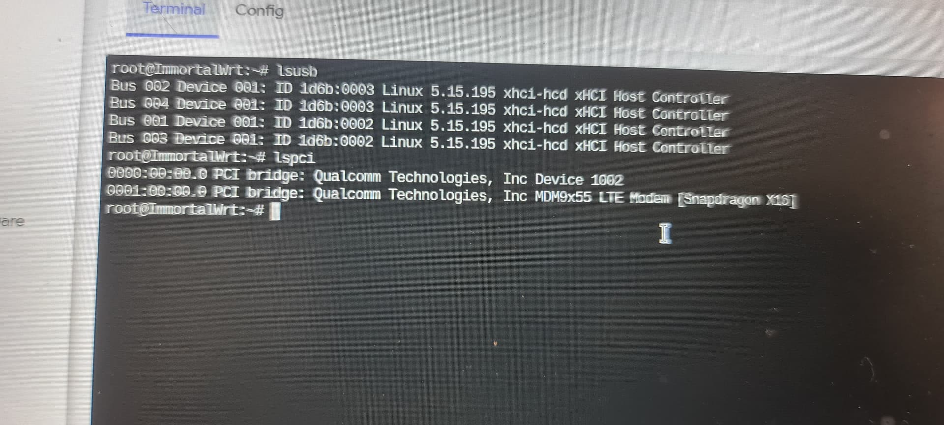

lsusb
lsusb -t
im use openwrt 24.10.X kernal 6.x, and use qmodem
root@OpenWrt:~# lsusb
Bus 001 Device 001: ID 1d6b:0002 Linux 6.12.57 xhci-hcd xHCI Host Controller
Bus 002 Device 001: ID 1d6b:0003 Linux 6.12.57 xhci-hcd xHCI Host Controller
Bus 003 Device 001: ID 1d6b:0002 Linux 6.12.57 xhci-hcd xHCI Host Controller
Bus 004 Device 001: ID 1d6b:0003 Linux 6.12.57 xhci-hcd xHCI Host Controller
root@OpenWrt:~# lsusb -t
/: Bus 001.Port 001: Dev 001, Class=root_hub, Driver=xhci-hcd/1p, 480M
/: Bus 002.Port 001: Dev 001, Class=root_hub, Driver=xhci-hcd/1p, 5000M
/: Bus 003.Port 001: Dev 001, Class=root_hub, Driver=xhci-hcd/1p, 480M
/: Bus 004.Port 001: Dev 001, Class=root_hub, Driver=xhci-hcd/1p, 5000M
root@OpenWrt:~# lspci -nn
0000:00:00.0 PCI bridge [0604]: Qualcomm Technologies, Inc Device [17cb:1002]
0001:00:00.0 PCI bridge [0604]: Qualcomm Technologies, Inc MDM9x55 LTE Modem [Snapdragon X16] [17cb:0302]
root@OpenWrt:~#

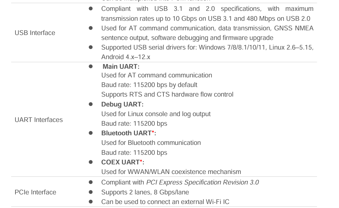

Could you please provide me with the latest firmware for the following device?
Manufacturer Quectel - RG501QEUAAR12A09M4G
Also, does this device support only MHI/PCIe, or does it also support USB?
Thank you.
