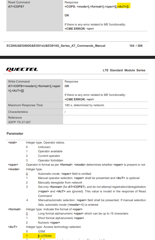

Yes, the module EG912U-GL support 4GVoLTE call and it will route the voice call and emergency call using 4G VoLTE.
The module’s FW does support LTE and VOLTE capabilities, meanwhile the developer needs to configure or enable supported VOLTE setting through AT command.
You can check whether the telco has been establish VOLTE or not using the command AT+COPS?
