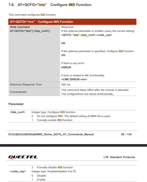

I think the first step is to enable the VOLTE on the module. Please follow this AT command and to enable VOLTE and try again:
AT+QCFG = “ims”,1,1
i will update you via mail if there is any new firmware update or you may need to capture us the logs for further analysis. Can you also share to us the current AT command flow used by your team for us to check?

We enabled IMS using:
AT+QCFG=“ims”,1,1
After further testing, we have made progress. With EC25-J Mini PCIe and a Rakuten Mobile SIM, VoLTE voice calling by ATD is now working in our environment, and the remote party can hear the prompt audio.
