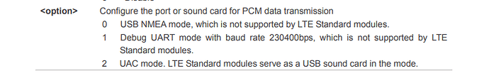

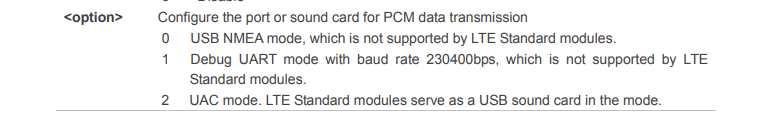

Is there any plan to release a firmware update which supports better audio quality over USB? Based on the application notes, I see that UAC is the only option for EC25:
For reference, I’m currently running firmware EC25EUXGAR08A19M1.
