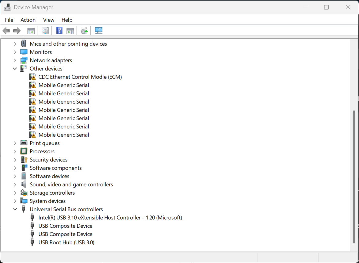

Thank you. I received the latest EC200UCNAAR03A17M08 firmware and QFlash V7.3.
I have connected the native USB interface of our EC200U-CN custom board to the Windows PC.
The module is detected as:
USB\VID_2C7C&PID_0901
and Windows detects the parent device as USB Composite Device.

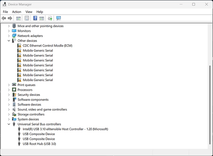

However, the child interfaces are shown under Other devices as:
CDC Ethernet Control Model (ECM)
Mobile Generic Serial
with yellow warning icons, and no Quectel USB AT Port (COM) is created.
Could you please provide the correct Windows USB driver package for EC200U-CN / VID_2C7C PID_0901, so that I can install the USB AT/DM ports and proceed with the A17M08 firmware upgrade using QFlash V7.3?
Thank you.

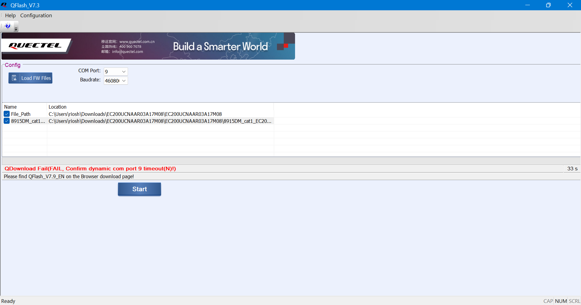

When I try the firmware upgrade with QFlash V7.3, it fails with:
QDownload Fail
(FAIL, Confirm dynamic com port 9 timeout(N)!)
It appears that the EC200U download interface is entering download mode correctly, but the required SPRD U2S Diag / UNISOC download driver is not installed/bound in Windows.
Could you please provide the official Windows driver package for the EC200U-CN SPRD U2S Diag interface (USB\VID_0525&PID_A4A7)?
Also, QFlash V7.3 displays a message recommending QFlash V7.9. Please confirm whether I should continue using the V7.3 package you provided or use QFlash V7.9 for flashing EC200UCNAAR03A17M08.
Thank you.
I have sent you the latest USB driver. Please try again.
Hi Quectel Support,
Thank you for providing the latest USB driver.
I was able to install the driver, enter the firmware download mode, and successfully upgrade the EC200U-CN firmware.
