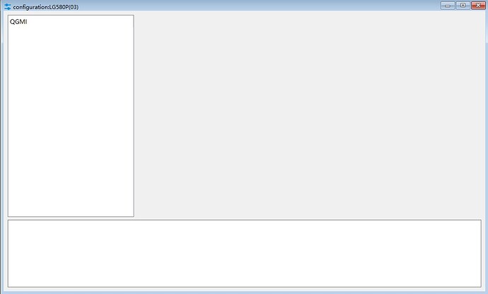

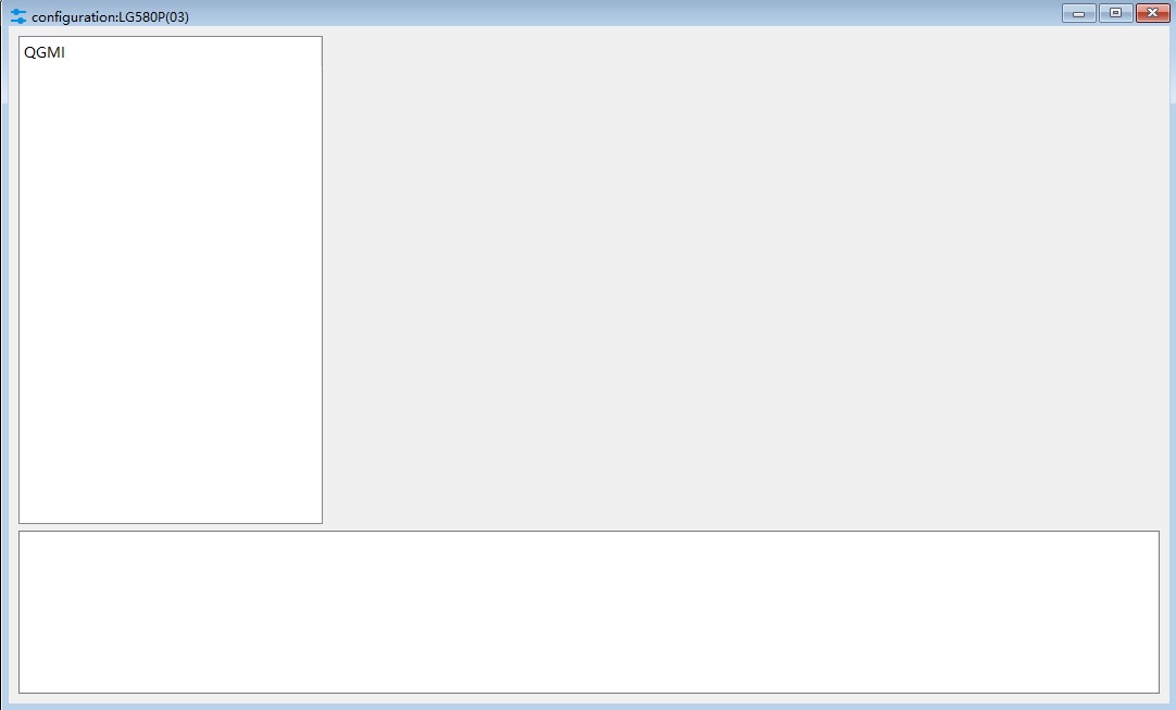

I have a module based on the LG580P. I have v2.2 of QGNSS software. I don’t understand how to configure the module. According to the manual all of the settings should be configured in the View - then Configuration View. This is what my configuration view looks like.
I want to change what NMEA sentences are output, how often, GNSS systems used, etc.

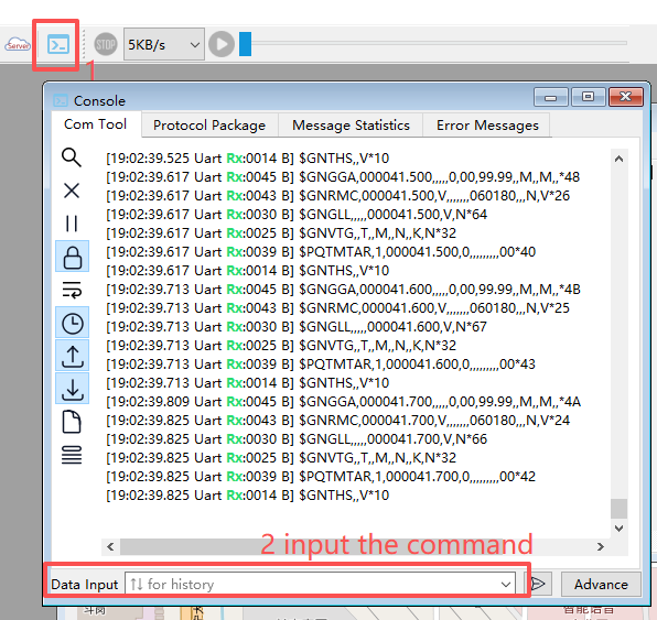

The GNSS module uses the NMEA protocol instead of AT commands. I’ve attached the manual for the LG580P, please take a look.
And then send the command to console.
