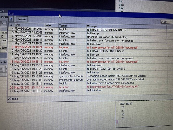

Hello! I have a Quectel EM160R-GL with firmware EM160RGLAUR02A07M4G and want to use it in Mikrotik RBM33G. I set modem to MBIM mode, he started successfully, but sometimes there is a disconnect. Can You please, say, what i can do to fix it?
When disconnected, I restart LTE-interface and wait 5..7sec and the connection is repaired and works successfully.

I had written to Mikrotik support. They say this:
This looks like a modem firmware issue, before the connection is lost modem does not respond to RouterOS request like:
2021.04.23-14:44:26.06 @@net@@ @0 lte1 mbim: error: function error: not opened
Apr/23/2021 17:44:27 lte,error lte1: reply timeout for: AT+QENG=“servingcell”
This looks the same as an issue we reported to Quectel for another modem model.
Please check for modem firmware upgrade and update it when it is available.
