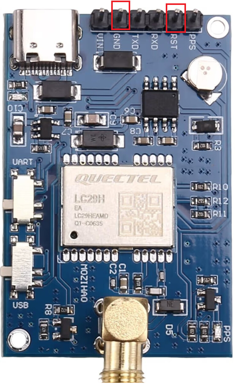

Hi @B_J in your case, you can use a jumper then connect with RST and GND pin as show as below picture:
Take note that you will only need to connect these 2 pins for at least 100ms. Then you will need to release or remove the jumper. The firmware update should be able to continue as usual.
Let me know if have any issue after try this one out. Best regards,
@mohamad.firdaus …does not work due to the jumpers position.
To enable the ttl pins must switch the position and flash with a ttl to usb connector , because the usb is disabled.

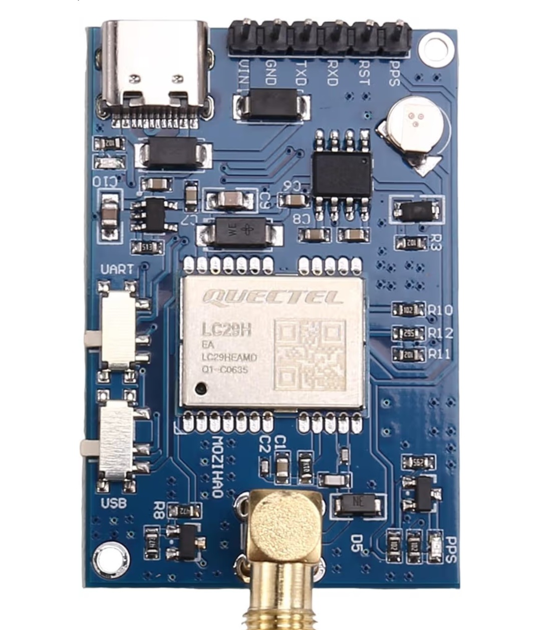

Hi @bamarcant and @mohamad.firdaus, I’ll have the same motherboard soon. How do I reset the motherboard to update it if I’m connected via USB? I saw a comment from @bamarcant but I can’t find it anymore. He mentioned briefly connecting pin 8 to ground. I’m not sure which pin is pin 8 or if it’s safe to do that. Can you help me with that?
Regards, Angel

If I connect to the PC with a TTL-USB adapter, will the RST pin and ground connection work?
Or is this RST pin not connected to the LC29h?

Si, dovrebbe funzionare ma ricorda di cambiare posizione al commutatore…
la board mozihao ha problemi con tx ed rx sulla morsettiera ttl dovuto a delle rsistenze da 1k troppo grandi, o le togli o riduci a 100mOhm…
