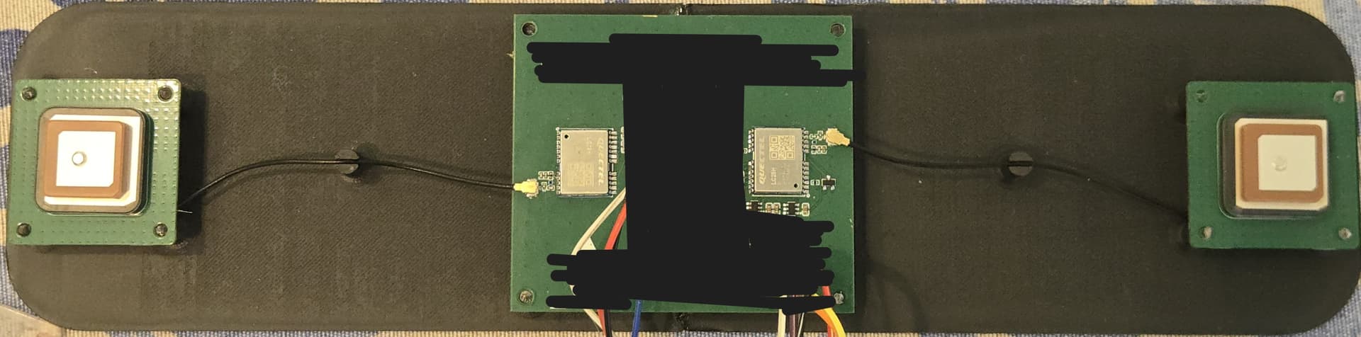

  • Application: Compact marine GNSS satellite compass

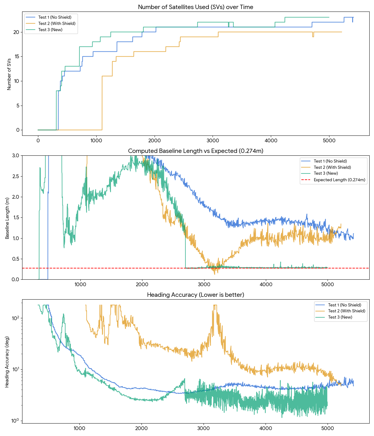

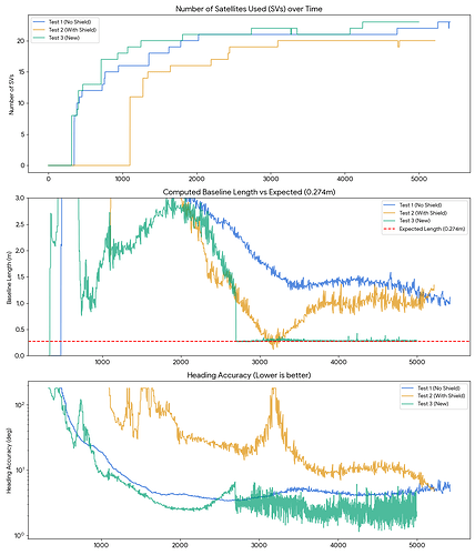

Finally after some tuning I get the the heading ( green line) with precision about 4°
Hello zizouth.
I experience the same problem you describe in the previous post, never reaching an RTK fix in moving base configuration using 2 LC29HEA.
What tuning did you do to reach 4 degrees precision?
