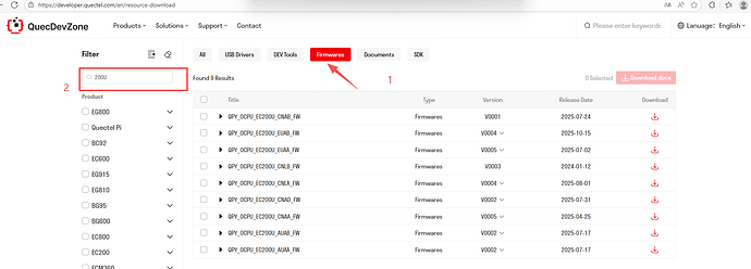

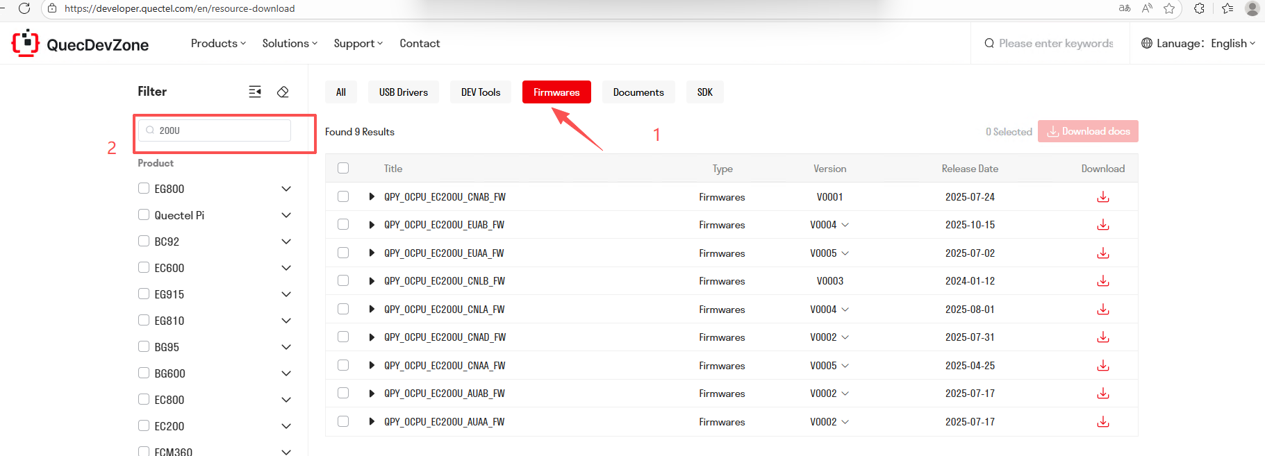

yes i am using built in GNSS.Can i know where can i find firmware for QuecPython for EC200U-CN
hi sravya
please refer to the link below
Resources Download | QuecDevZone
