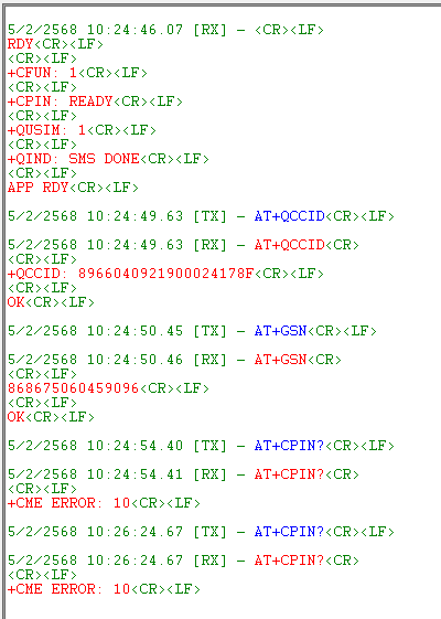

Why CPIN ERROR +CME ERROR: 10 (BG951A-GL)
When starting power on module result is +CPIN: READY,But when using AT+CPIN? result is +CME ERROR: 10
Send AT+CMEE=2 and then try AT+CPIN? again, it should report the error as text. But error 10 means SIM is not inserted, which is weird because you got ICCID. Try AT+QSIMSTAT?, the second number in the response is 0=removed, 1=inserted, 2=unknown (yet).
