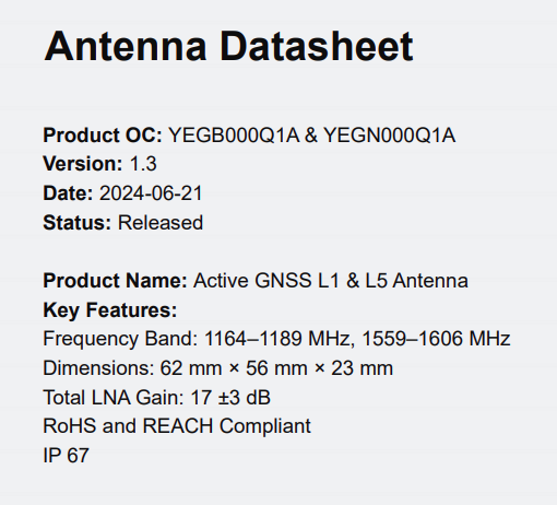

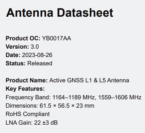

Both YB0017AA and YEGB000Q1A are feasible for LC29HEA.
YEGB000Q1A has better ingress protection level IP67, while YB0017AA has IP64.
YB0017AA has a higher total gain, which has higher chance to get RF signal oversaturation. Higher gain is designed to overcome some potential signal attenuation.

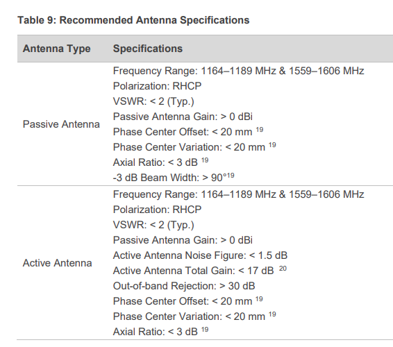

The requirement of LC29HEA antenna selection is shown below:

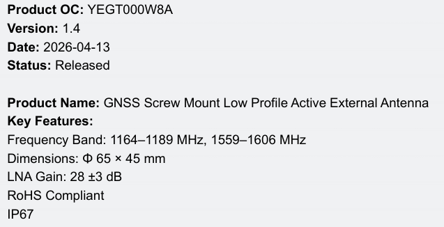

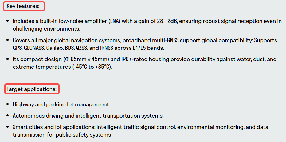

Hi, is YEGT000W8A a suitable antenna for a LC29HEA ?
Hi @mkergo35 YEGT000W8A antenna has higher gain which 28 ±2dB. This is a high-performance active external multiband antenna. You may further check from here: YEGT000W8A GNSS L1 + L5 low profile active external antenna.
However, it is best for you to know what kind of application that you intended to use.
