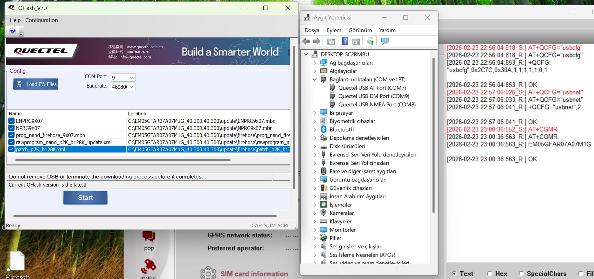

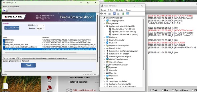

Thank you for the firmware file. However, I am experiencing an issue during flashing — it fails in QFlash with the error :
DL_Firehose error / Firehose timeout
By the way, my EM05-G came pre-installed inside an OEM installed Lenovo laptop.
While trying to resolve the issue, I may have accidentally changed the USB configuration (usbcfg ) without being sure if it was correct. After that, the BIOS showed an “Unknown network card” error, which I managed to resolve by setting the PID back to 0x30A, and the error disappeared. However, I am not sure whether the current USB configuration (PID) is correct — could you please confirm if my current usbcfg setting is appropriate for a Lenovo device?
I have tried both the DM port (COM9 on my PC) and the Qualcomm HS-USB QDLoader 9008 port, but both result in a timeout error.
I have attached screenshots for your reference. As I have not dealt with this type of issue before, I would really appreciate your guidance.
