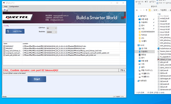

When you start the firmware program, it automatically turns off after 3 seconds
When you start the firmware program, it automatically turns off after 3 seconds.
I didn’t see you select the firmware.
Please click the
“Load FW Files”
The program automatically shuts down after 3 seconds before starting the program and selecting the firmware
OK. Maybe you can try the older version.
If the QFlash 7.0 also not working maybe you can try the QFIL which is the tool from Qualcomm.
Where do I download QFlash 7.0? be nowhere to be found
Here, but I suggest the 4.18 version…there are also em12 files inside,but qflash is fine to work with eg25.
Quectel_QFlash_User_Guide_V3.1.pdf (1.8 MB)
In the repository are also other upgraded qflash versions…
Regards
Even if you try to update the firmware all day, it fails. Please someone help me ㅠㅠ
