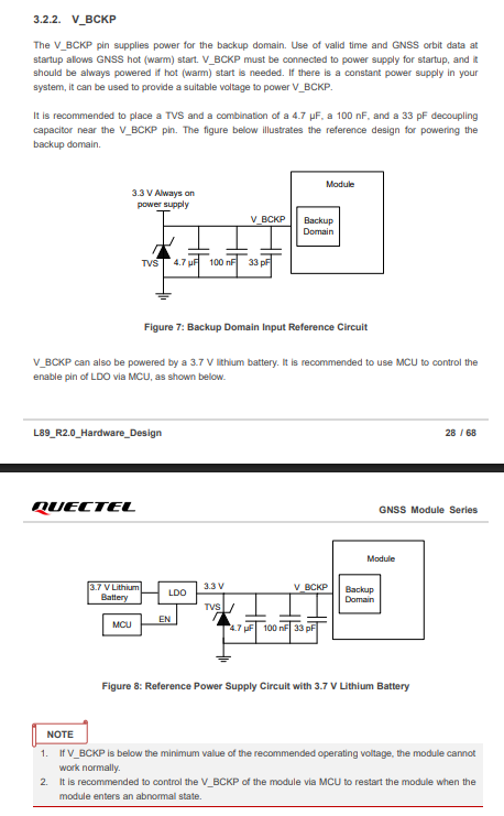

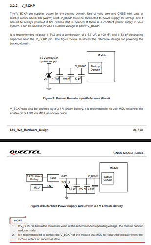

Does backup power is mandatory for GNSS module if we don’t require hot start or warm start. What happens if backup is not provided.
If main VCC is failed how much time it will work on non rechargeable battery or rechargeable battery
