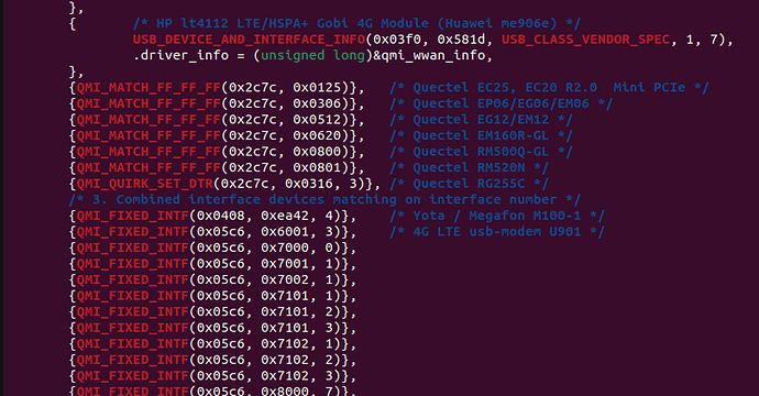

For the Linux driver, you need to modify the qmi_wwan.c and recompile the qmi_wwan.ko.

Hi i checked with the current configuration.
What does the 3 suggest in configuration. Is it an interface for internet. Does rg255cgl work with QMI or MBIM. I am still stuck at getting the pdu sesssion.
If you need any output let me know in the chat i will send you.
Kindly mention the respective cmmads as well.
The USB interface 3 is for usbnet qmi_wwan.
I am still facing an issue. Can you spot what i am missing?

The modem might not be in RMNET mode.
Please check
AT+QCFG="usbcfg"
Please try the quectel-CM 1.6.8.
q_drivers/Quectel_QConnectManager_Linux_V1.6.8 at master · QuectelWB/q_drivers
AT+QCFG=“usbcfg”
+QCFG: “usbcfg”,0x2C7C,0x0316,1,1,1,1,0
Sorry. Please check
AT+QCFG="usbnet"
HI can you check my logs . I followed the Querry Linux Driver RG255C-GL for Linux 6.1.0 because modifiying the qmi_wwan.c and option.c didnt help. It always give the symbol error, vmlinux not found and donot build .ko file.

Any work arround?
For normal version it do not support MBIM mode.
Please set the modem to RMNET mode.
AT+QCFG="usbcfg",0
