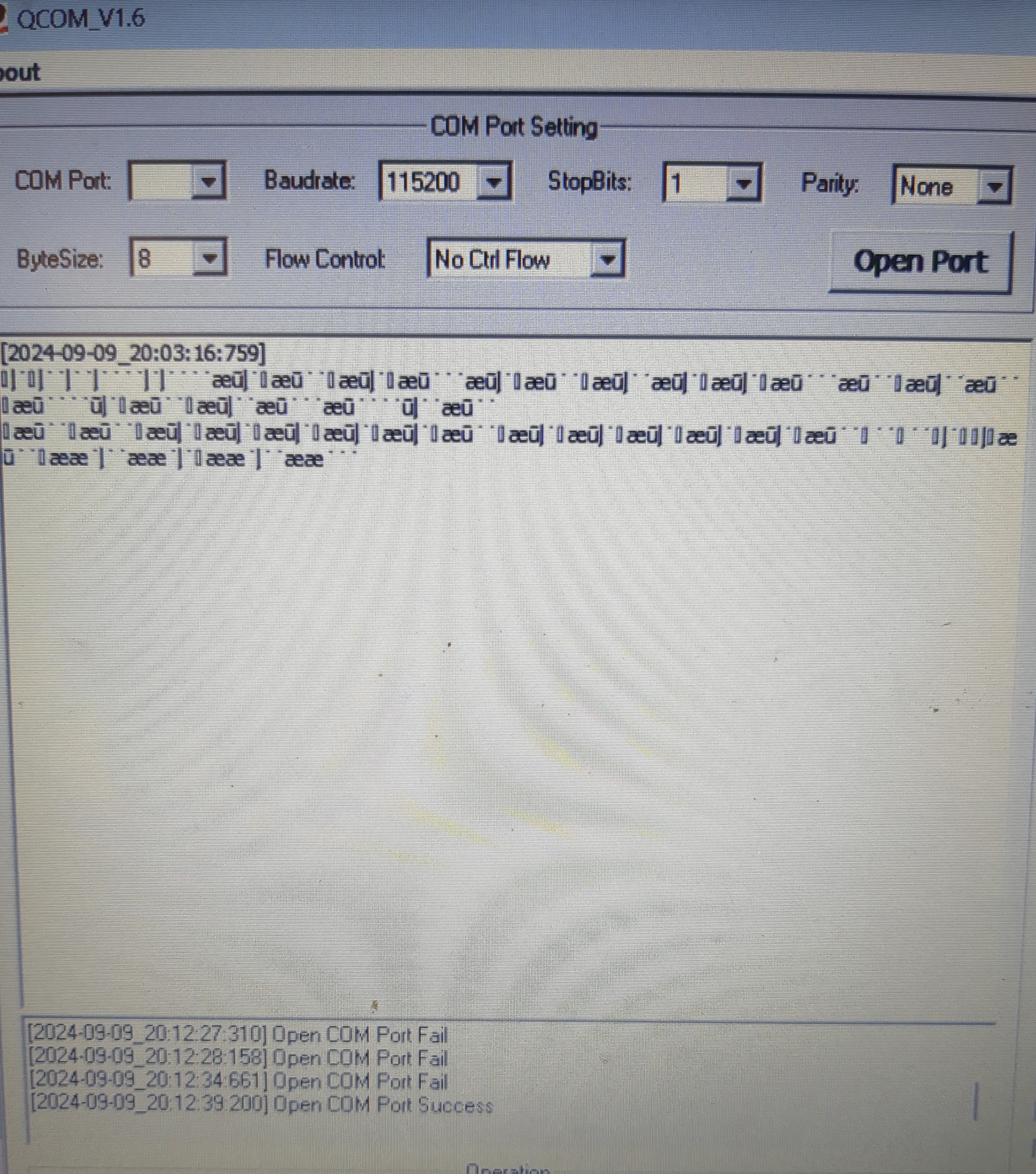

Hello, i have connected mc25 PLC to ttl module via usb successfully. i am using qcom_v1.6 but i am receving unreadable symbols in command window. Wiring is ok, i connected rx, tx and com. Port is openned. Maybe you know what could be wrong? I am attaching photo bellow.

You can check whether you are connecting main_tx and main_rx, and confirm the baud rate of the module. Send AT at the same time to see if you can get the correct return. Second, check if your module burns the sdk? Still standard fw

It is a bit unclear to me how to check baud ratio as i tried every selection.
