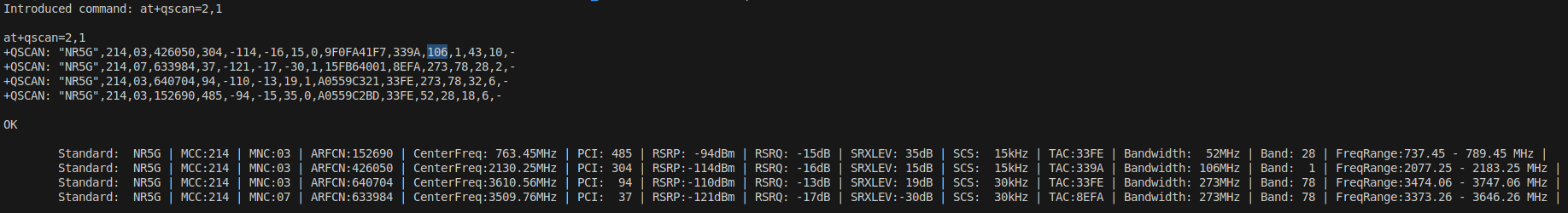

Good morning,
I noticed that the modem is reporting unusual bandwidth values when using the AT+QSCAN command. As can be seen in the attached photo, values such as: 52 MHz, 106 MHz and 273 MHz.

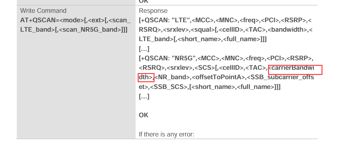

Dear @Carlos_CM
In NR5G, it is carrierbandwidth. Not bandwidth.
Integer type. Carrier bandwidth, the number of the RBs in sub-carrier.
