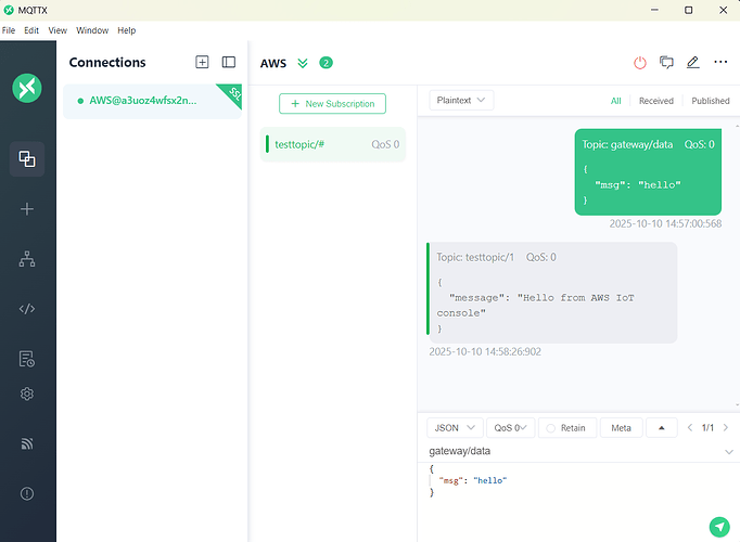

@herbert.pan-Q
I followed the same steps and confirmed the certificates are valid, still its not working while using with gsm module.
Please use the mqtt.fx or mqttx tools to verify the correctness of the certificate.
i tested with mqttx
And confirmed the certificates are valid
pls see the logs
[All](javascript:;)[Received](javascript:;)[Published](javascript::wink:
New Subscription
[testtopic/#](javascript:;)QoS 0
Topic: gateway/data QoS: 0
{ “msg”: “hello” }
2025-10-10 14:57:00:568
Topic: testtopic/1 QoS: 0
{ “message”: “Hello from AWS IoT console” }
2025-10-10 14:58:26:902
