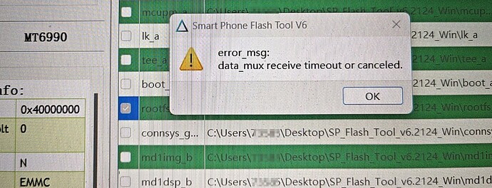

Hello, I used SP flash tool to flash my firmware for RG620T, before that I did a readback backup, but it reported an error that it could not be backed up, what is the problem?
I successfully backed up and flashed RG620TEU00AAR03A04G4G_OCPU_AA04_01.001.01.001_V01, but I don’t have the web access password? What is his password?
