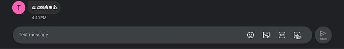

@snowgum Thanks for your support. Finally we did SMS in religion languages. In both TEXT mode and PDU mode. But the TEXT mode was not supported in my old modem firmware version. I am getting a another version from Quectel support (EC200UCNAAR03A14M08) ,That works in TEXT mode also.
TEXT MODE:
[2025-03-19_09:28:31:009]ATI
[2025-03-19_09:28:31:009]Quectel
[2025-03-19_09:28:31:009]EC200U
[2025-03-19_09:28:31:009]Revision: EC200UCNAAR03A14M08
[2025-03-19_09:28:31:009]OK
[2025-03-19_09:28:32:025]AT+CMGF=1
[2025-03-19_09:28:32:025]OK
[2025-03-19_09:28:33:036]AT+CSCS="UCS2"
[2025-03-19_09:28:33:036]OK
[2025-03-19_09:28:34:036]AT+CNMI=2,1,0,1,0
[2025-03-19_09:28:34:036]OK
[2025-03-19_09:28:35:053]AT+CSMP=17,71,0,25
[2025-03-19_09:28:35:053]OK
[2025-03-19_09:28:36:057]AT+CSCS="UCS2"
[2025-03-19_09:28:36:057]OK
[2025-03-19_09:28:38:076]AT+CMGS="0039003100350030003000330033003200370035"
[2025-03-19_09:28:38:076]> 0BB50BA30B950BCD0B950BAE0BCD
[2025-03-19_09:28:39:942]+CMGS: 2
[2025-03-19_09:28:39:942]OK

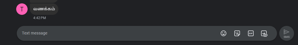

PDU MODE:
[2025-03-15_16:40:28:049]ATI
[2025-03-15_16:40:28:049]Quectel
[2025-03-15_16:40:28:049]EC200U
[2025-03-15_16:40:28:049]Revision: EC200UCNAAR02A09M08
[2025-03-15_16:40:28:049]OK
[2025-03-15_16:40:30:584]AT+CMGF=0
[2025-03-15_16:40:30:584]OK
[2025-03-15_16:40:33:365]AT+CSCS="UCS2"
[2025-03-15_16:40:33:365]OK
[2025-03-15_16:40:40:465]AT+CSMP=17,167,0,8
[2025-03-15_16:40:40:465]OK
[2025-03-15_16:40:43:732]AT+CMGS=27
[2025-03-15_16:40:43:732]> 0011000A81190530235700080B0E0BB50BA30B950BCD0B950BAE0BCD
[2025-03-15_16:40:46:497]+CMGS: 248
[2025-03-15_16:40:46:497]OK

Dear @UdhayaKumar_Mani & @snowgum ,
Thank for the interactive session on this issue and solved using PDU method.
This forum chat can be closed.
