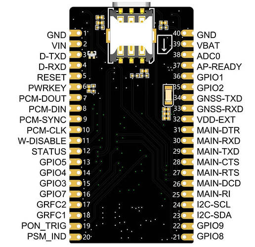

I’m testing the modules present in the BG95-M3 modem and I’m currently having difficulties handling serial communication tests between the QuecPython terminal and the information return port. To perform this procedure, I used this post as a basis.

Schematic:
GND = PIN 1 Development Board
RX(COM Port UART) - D-TXD Pin 3 Development Board
TX(COM Port UART) - D-RXD Pin 4 Development Board
P.s: I have also tried using the MAIN PORT (MAIN-TXD and MAIN-RXD), modifying the code to UART2.

I think the problem may be caused by the wrong pin of the test. May I ask what your board is ?

I think your problem is the BG95 board works on 18V and the usb to ttl uart converter works in 5V. You need to use a level converter.
