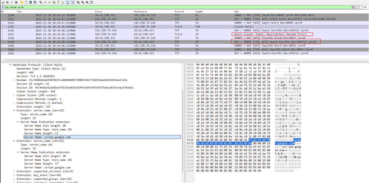

Any news about this issue?
Hi Saulius,
As per our latest email conversation dated 9/1/2026, the preliminary analysis has been sent to you.
Based on the analysis from our R&D team and the packet capture you shared, the HTTPS handshake does not proceed as expected. After the Client Hello (with SNI set to script.google.com), the HTTP server does not return a Server Hello, but instead responds with a FIN packet, causing the connection to be closed prematurely.
This behaviour typically indicates a server-side rejection during the TLS handshake phase.
Could you please help to confirm whether the EG800Q module has the correct root certificate installed that matches the Server Name (SNI) being used? A certificate mismatch or missing CA may cause the server to terminate the connection before completing the handshake.
Once this is confirmed, we can continue the analysis from there.

I may be misunderstanding something here, as I’m not a professional in this area. Could you please advise how I can check which root CA certificates (.pem/.crt) are installed on the EG800Q module? I couldn’t find a way to list or inspect them using AT commands.
Hi Saulius,
Sure. On the EG800Q, root CA certificates are not pre-installed like on a PC or browser. Instead, they must be manually uploaded by the user into the module’s internal flash file system, called UFS. The module will only use certificates that are explicitly uploaded and assigned.
Below are the steps to check this on the module:
You can list all files currently stored on the module using the file management command:
AT+QFLST=“*”
The response will show entries such as:
+QFLST: “UFS:filename.pem”,<file_size>
If you do not see any .pem or .crt files in the list, then no root CA certificates have been uploaded to the module yet.
Please feel free to share the output of AT+QFLST=“*” and the SSL configuration, and we can continue the analysis from there.
Thank you!
