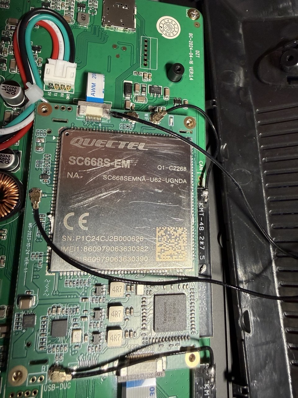

How about the antenna do you connect it?
And do you test with another SIM card?
The LTE antenna is connected properly to the MAIN LTE connector of the SC668S module.

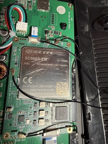

By the way, canyou share the device IMEI1 and the picture for the device.
I want to confirm whether you can download our officail firmware
IMEI1: 860979063630382
