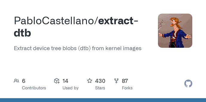

Hi msangalli
Actually amost all the dts like msm8909* are compiled into the boot.img.
It provide a way for you to extract the dtb from the boot,img.
And then you can use the dtc to objdump the dtb. Then you would get the dtsi.
Which dtsi are compiled, you can check the arch/arm/boot/dts/qcom/Makefile.

Hi Bean Wang: thank You very much!
The tool is very usefull!!!
I’ found that in the boot image are store up to 54 dtb:
in effect all of the msm8909-related dtb stored in arch/arm/boot/dtb/are used,
