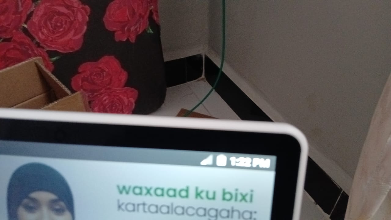

I am using a Quectel SC20-E module on an Android-based device deployed in Somalia.
The device connects to Wi-Fi networks without any issues, so the Android system and networking stack are working correctly.

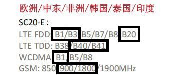

For cellular, I’m using a SIM card from a local telecom operator. Based on the carrier’s documentation, the SIM supports multiple LTE bands that overlap with the SC20-E supported bands.
Current behavior on cellular:
  • SIM card is detected correctly
  • The device shows signal bars in the Android status bar
  • However, no 4G/LTE data connection is established
  • Mobile data does not work even though the SIM has active data
I would like to understand:
  • If LTE band incompatibility can result in signal bars appearing but no data attachment
  • Whether this could be related to APN settings, network mode, or modem configuration
  • If there are any required AT commands or Android-side configurations needed for LTE data to work properly on SC20-E
