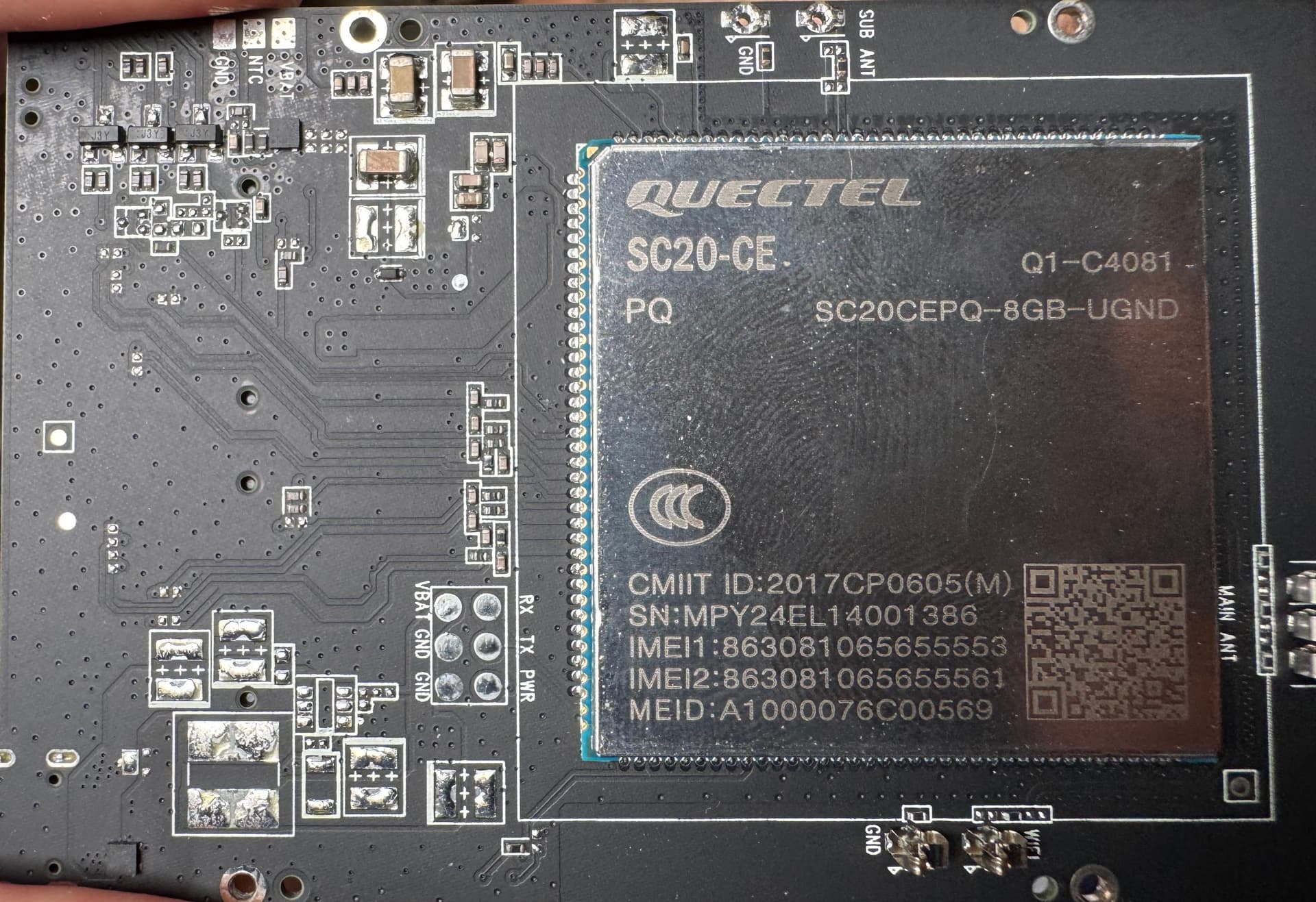

Hi Kline, thank you for responding and i will defienetely share all the data with you and the image of the device as well.
device Ikos k7 quectel sc20-ce
imei 1: 863081965655553
imei 2: 863081065655561
software version 1.2.8
firmwire:26
date 2025/04/10
