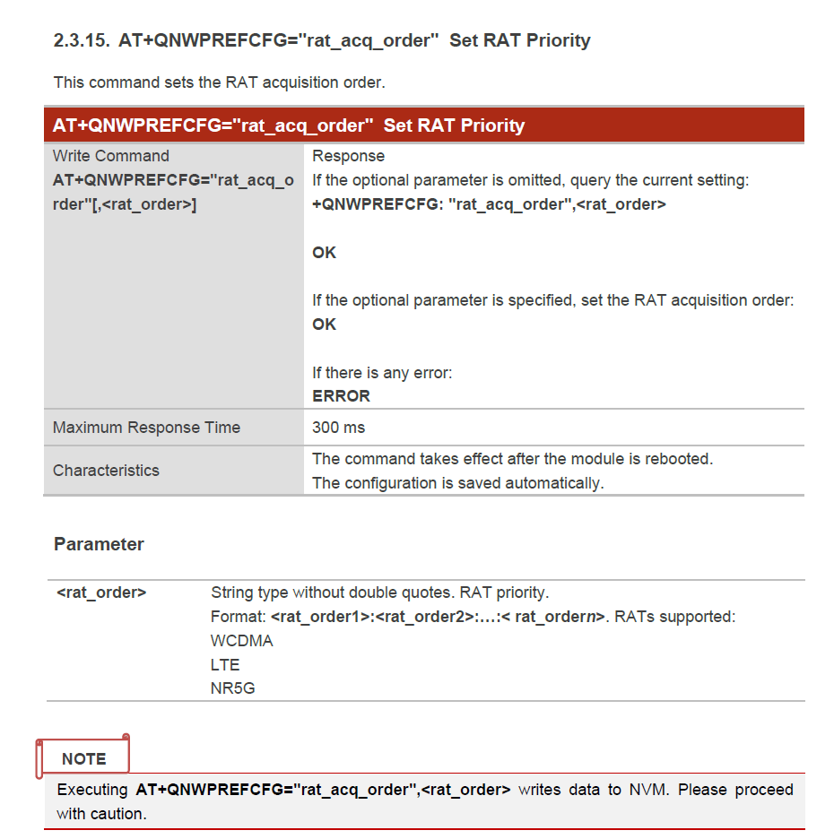

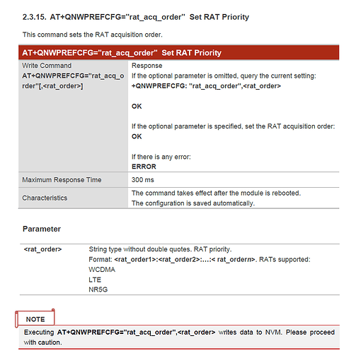

hi @herbert.pan-Q thanks.
one question, AT+QNWPREFCFG=“rat_acq_order”
in RM551E, this value changed during sim change. how can I make it permanent to NV?
Dear @morpig
This command is saved automatically, is there any issue on your side?
