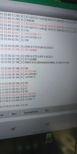

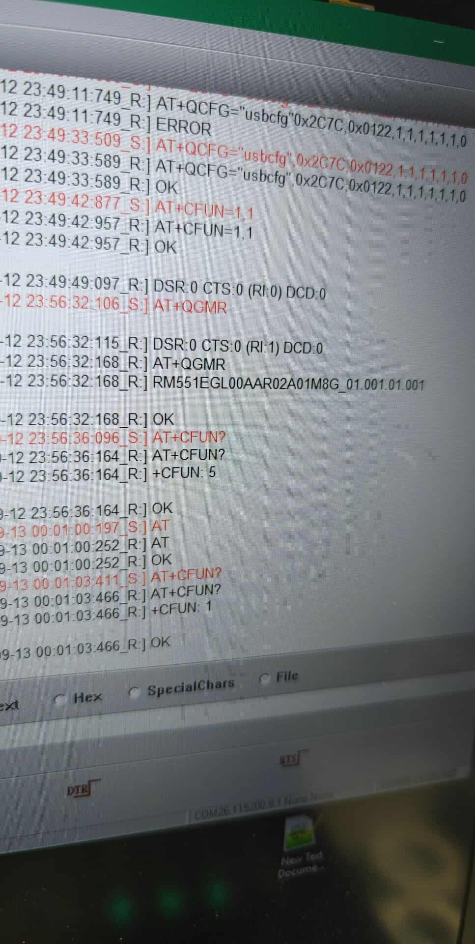

@silvia
Actually I was successful with upgrade between R01 and R02
Steps taken:
Using QPST, make an xqcn backup
Using QFIL or Qfirehose erase all flash R02
Using QPST restore the xqcn backup to regain CFUN 1
Dear @iamromulan
Did you check CFUN status before backup QCN?
@silvia
Yes it was CFUN=1
The erase all operation removes the xqcn data from the module which caused CFUN=5 on module first boot. After restoring the xqcn CFUN=1.
