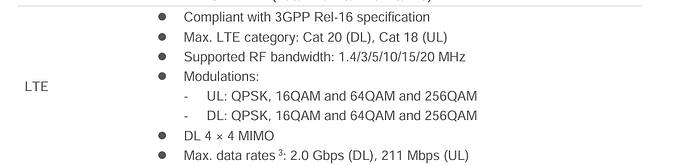

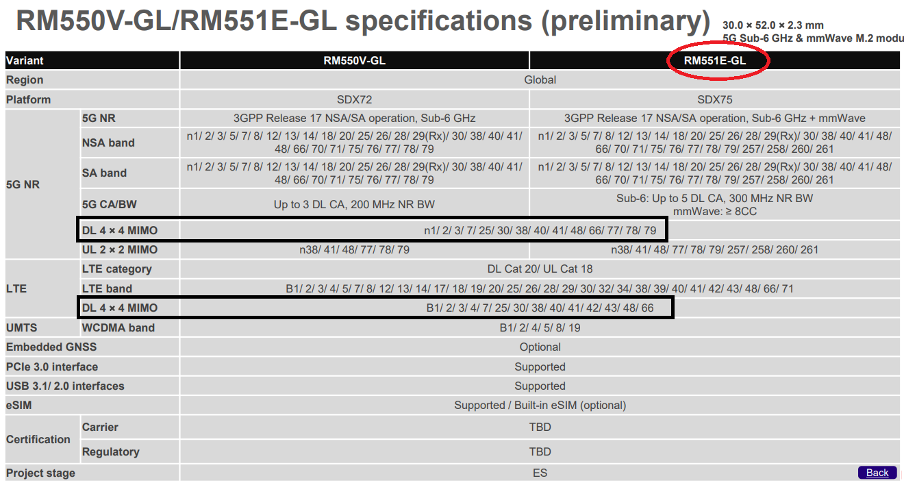

“I checked your spec, RM551E-GL does not support DL 4x4 on low bands.”
=>Which document do you see?
I checked HD document, it showes as below:
Dear @silvia
In your Quectel_Product_Brochure_V8.3.pdf there is no mention of MIMO so I found this picture. It does not state that it supports DL 4x4 on low bands. Everywhere on the internet this is stated from the picture where there are no low bands under DL 4x4.
Compared to your picture - the 3GPP release version doesn’t match either (your picture says release 16, but everywhere on the internet it says release 17 - which one is correct?).

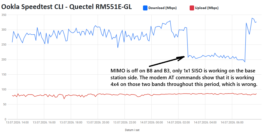

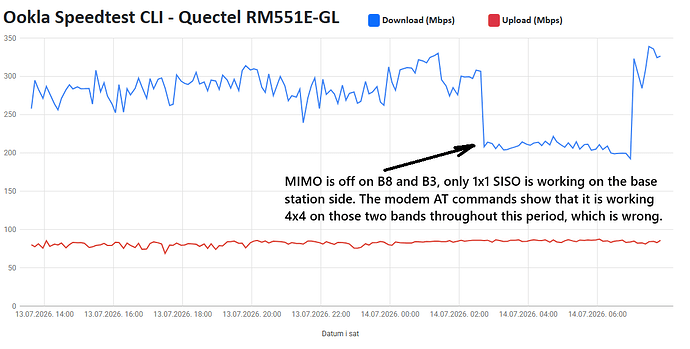

Anyway, the AT command at night returns to LTE B8 with faulty MIMO because the ISP confirmed to me that then the power saver turns off MIMO, only 1x1 SISO works.
Nothing matches anything…
Tonight MIMO is off on B8 and B3, only 1x1 SISO is working on the base station side.
Modem AT commands show that it is working 4x4 on those two bands throughout this period, which is wrong because then there would not be a drop in speed but an increase if the MIMO data is true.
+QENG: “servingcell”,“NOCONN”
+QENG: “LTE”,“FDD”,219,01,24A160A,298,500,1,5,5,1068,-93,-8,-64,15,10,190,-
+QENG: “NR5G-NSA”,219,01,739,-74,13,-10,156510,28,1,0
+QCAINFO: “PCC”,500,100,“LTE BAND 1”,1,298,-93,-7,-65,12
+QCAINFO: “SCC”,1300,100,“LTE BAND 3”,1,298,-93,-9,-76,14,0,-,-
+QCAINFO: “SCC”,3600,50,“LTE BAND 8”,1,298,-85,-16,-61,8,0,-,-
+QCAINFO: “SCC”,156510,1,“NR5G BAND 28”,739
+QNWCFG: “lte_mimo_info”,298,500,2,1
+QNWCFG: “lte_mimo_info”,298,1300,4,0
+QNWCFG: “lte_mimo_info”,298,3600,4,0
+QNWCFG: “nr5g_mimo_info”,739,156510,1,1
AT commands for LTE MIMO info and NR5G MIMO info simply give wrong data in modem FW RM551EGL00AAR01A04M8G_A0.001.A0.001
