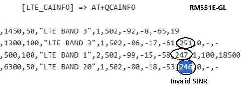

SINR BUG
When modem changes direction or eNB - in SCC cells SINR gives wrong values (240+)

However, incorrect SINR values appear in AT+QCAINFO at random intervals

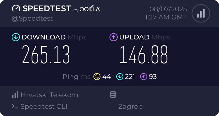

Here is a video comparison of UL speeds, old vs new modem.
Same cells, CA, antennas and base station.

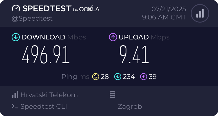

It is clearly visible that the new RM551E uses lower modulation in upload and at the time of testing UL CA did not work. UL CA works very rarely, I do not know by what principle, it does not even matter if the PCC is B3 band.
At the time of testing the modem was obviously using UL 16QAM but a good part of the time it uses UL QPSK so I have upload speeds of 5-15 Mbps.
Apparently the new RM551E does not know how to negotiate the max UL modulation and UL CA with the base station compared to the old RG501Q-EU.

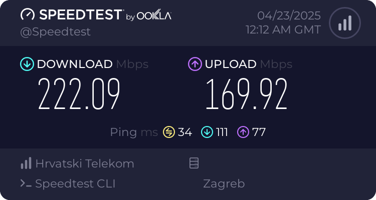

Just so you know, the old RG501Q-EU modem gave an upload speed of up to 150 Mbps on the same B1+B3 cells (a month ago)…
…and the record is 170 Mbps in upload on the same B1+B3 cells:
