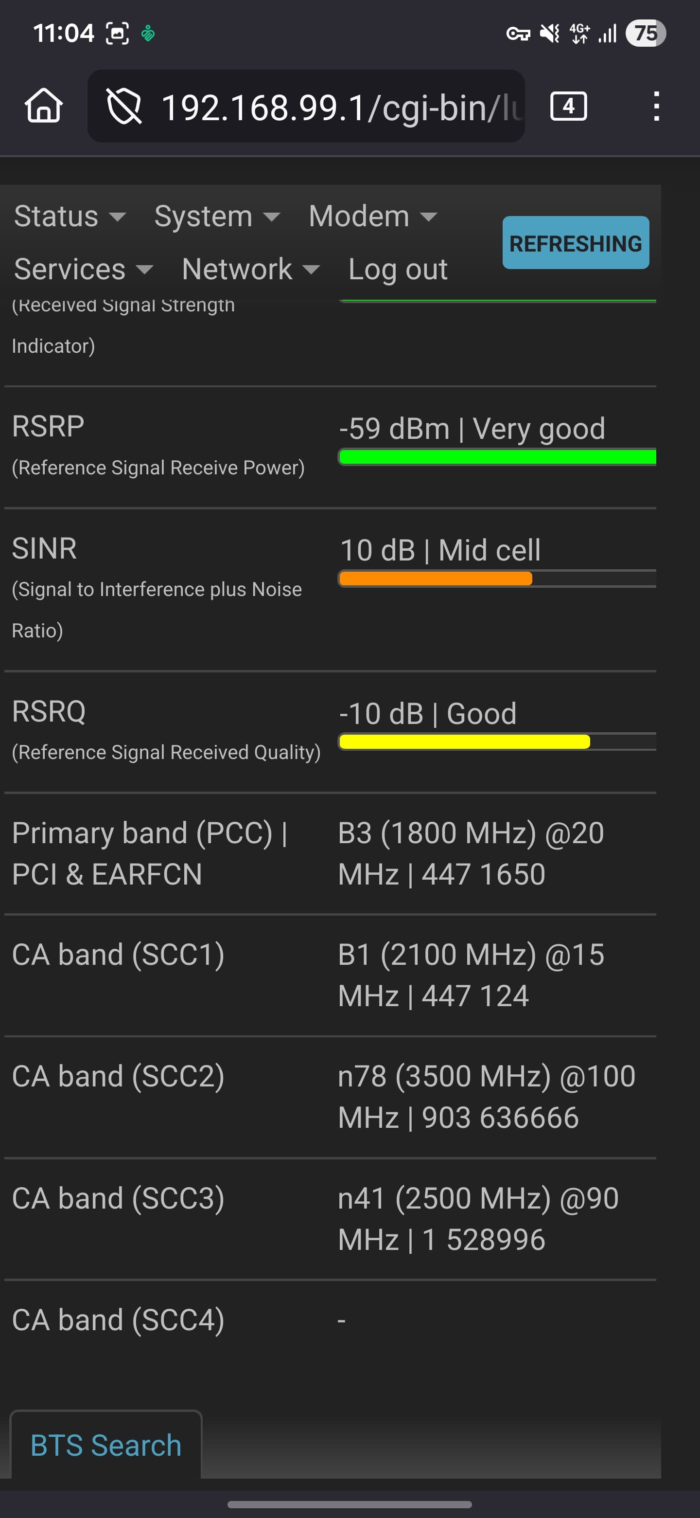

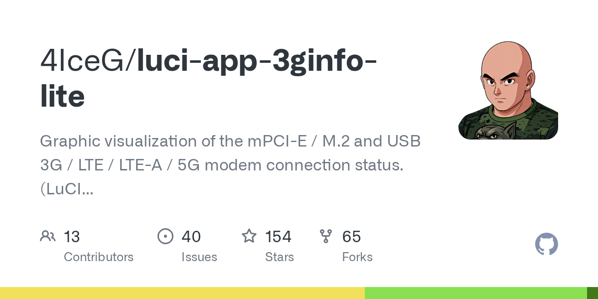

Also can you please tell me the name of this openwrt package that’s in your screenshot? Thank you!
currently around 1200 down 130 up on the best scenarios, that’s with latest firmware update A04, previously i was having troubles with the upload, i was getting 30 mpbs max with firmware A03.
package on screenshot is custom package called 3ginfo-lite by 4iceG:
it is not fully compatible with RM551E-GL though :sweat_smile:
