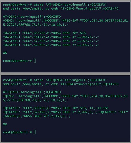

Are you able to check if 5CA in 5G SA mode supported for the rm551e-gl? eg n78+n1+n3+n7+n78.
Usually my modem connects via 3CA on n78+n7+n78. But today I noticed the modem connected via 4CA on n78+n1+n3+n7.
I’m currently running firmware RM551EGL00AAR01A02M8G (Dec 2024) on EE UK network.
Thanks!
Dear @mestrebali
It supports 5CA, but not supports n78+n1+n3+n7+n78.
I have sent 5CA list to you via Message, please check.
