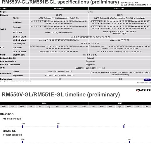

Is there any newer firmware for the RM550V-GL than 2024-06-06 ?
Its strange because originally the plan was for development to happen with RM550V before the RM551E. Yet we have had 4 firmware versions for the 551 and it seems only 1 for the 550.
