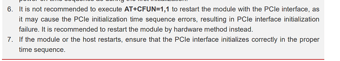

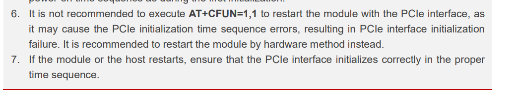

After I change to the PCI module with below command, sometimes they can bee seen via pci with “lspci”, however, if i reboot the system, they may lost the pci connection, back to USB, and hard to recover to pci again,
I try both the driver of mhi_pci from Quetuel and mhi_pci_generic from ubuntu, result is wired, who can help me on that, to stable the work mode?
Below is the AT command for reference. Thanks!
AT+QCFG=“data_interface”,1,0
AT+QCFG=“pcie/mode”,0
AT+QCFG=“usbnet”,2
AT+CFUN=1,1
